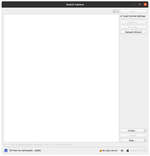

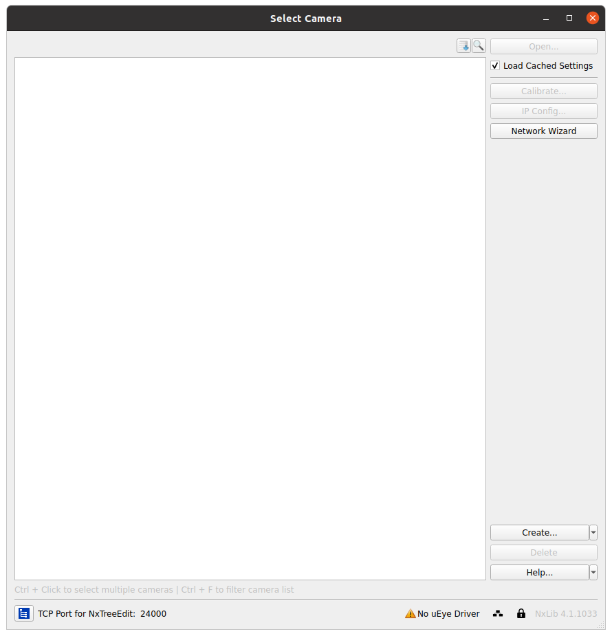

I am not able to connect/discover a B57-4 from NxView after running the network configuration wizard.

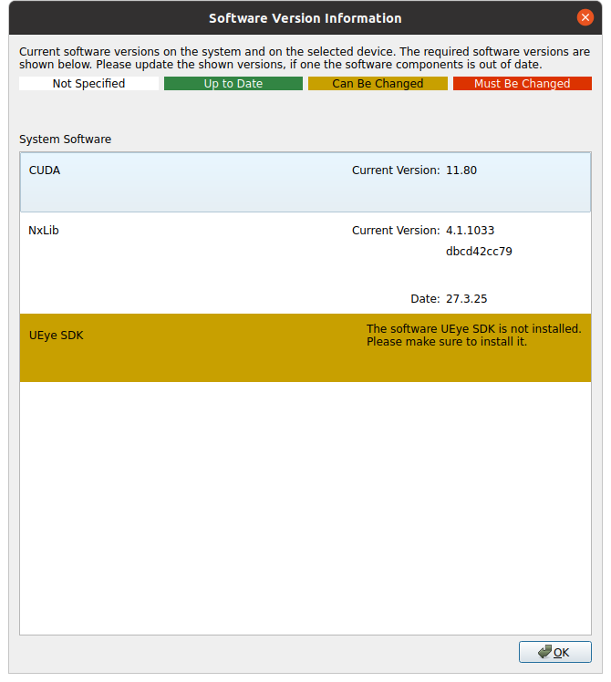

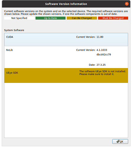

Below are the specs of of my system and screenshots of NxView.
