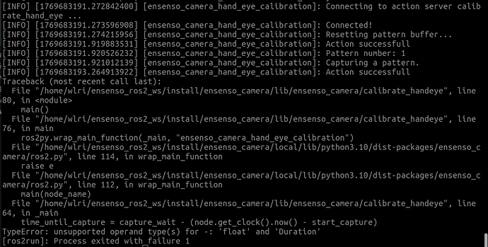

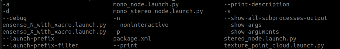

With ros2 launch ensenso_camera I only see following launch files:

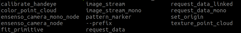

With ros2 run ensenso_camera I see following executables:
I assume I need to use ros2 run ensenso_camera calibrate_handeye which leaves me with the following error:
It seems there is a type mismatch?
Also, according to the manual (roslaunch … see above) I need to pass launch arguments, but how can I do that if I dont have a launch file called calbrate_hand_eye.launch in the ROS2 environment?
Hi @RomanHaas,
thanks for the report. There is indeed a bug in our ROS2 Python compatibility layer leading to the type mismatch error you observed. I pushed a fixed to ros2-fix-hac-script. You can check out this branch if you like. As soon as it passes the review it will be brought to master.
Regarding your question: You can always run the camera node in one terminal while calling the script in another, as you showed above. This is what the launch file would actually do if it existed. For ROS1, which required the roscore to be run additionally, this was very convenient. For ROS2 we decided to port only the basic launch files. You can probably create it yourself if you stick to the example launch files we provide.
Kind Regards
Benny
The fix has been merged into master. Let me know if you encounter any further problems.
