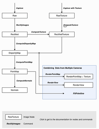

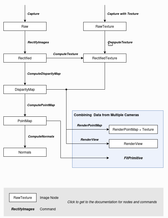

Please consider the illustration of the NxLib binary pipeline taken from our manual:
Once you have calibrated the link between the left C57 and the right C57, triggered both and computed a point map for both, you can combine the two point maps using RenderPointMap.
I still do not quite understand what you mean by “keeping left camera as reference as “left””.
If you want the combined point map from the perspective of the left C57, you must give its serial number in the Camera parameter.
If you want all point maps to be relative to the left C57, clear the left camera’s link like I explained above.
If this does not answer your question, please explain your question to me again in more detail and also refer to our guide on multi camera setups.
