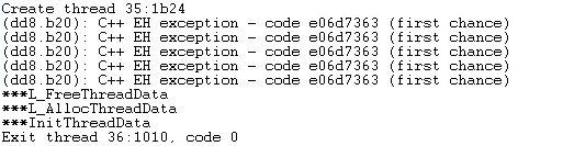

While we are still investigating the root cause, we have observed a suspicious behavior in NxLib immediately after the camera is opened:
  • A high‑frequency cycle of thread creation and termination (log entries such as L_AllocThreadData and L_FreeThreadData).
  • C++ exceptions are continuously thrown from within NxLib64.dll.
    These exceptions appear to be handled internally, but they are visible when a debugger is attached.
We have confirmed that the same behavior occurs not only in our own application, but also in the provided nxSimple sample program. By adding an idle period after the camera open command and attaching a debugger, we can observe it.
Is this repeated thread creation/termination and continuous internal exception throwing an expected behavior of NxLib?
Hi @yanofumiya.
The NxLib creates and terminates a lot of threads during normal operation and catches thrown exceptions internally. We strive to reduce both over time but for now: your obervations are to be expected and do not necessarily indicate a problem within the NxLib.
