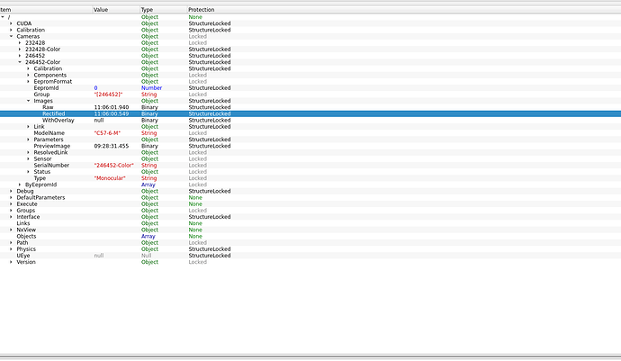

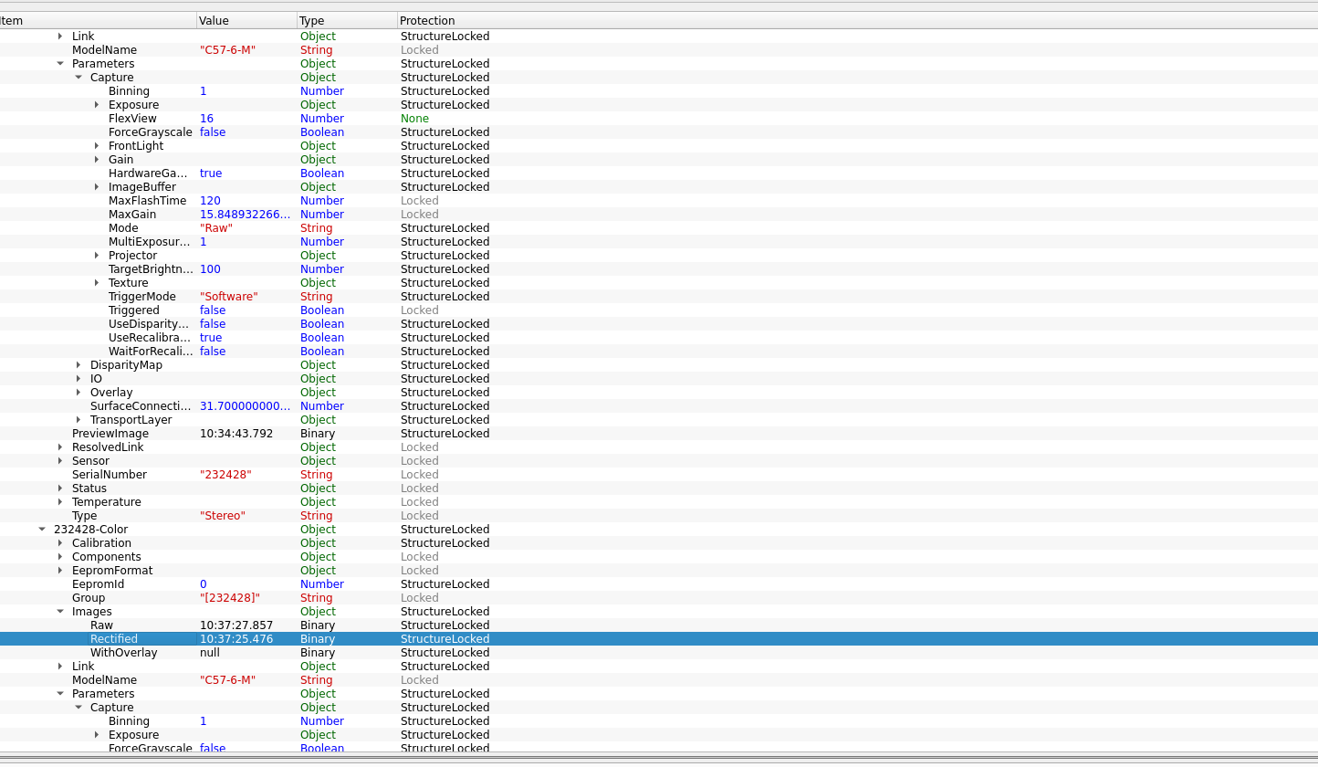

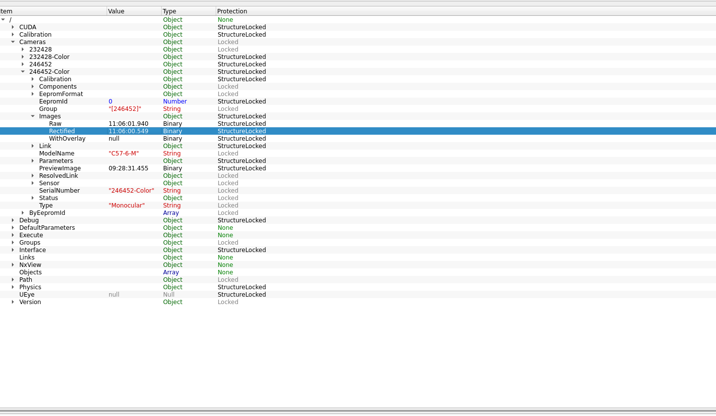

Hi @benthie
These are the screenshot of tree with color and stereo , iam confused i hope this is the answer if its not please let me know. When i clicked in rectified i showed as a actual rectified image. i would like to get these data and also how can i get good dense colored pointcloud in the sdk and now it is little bit of noisy

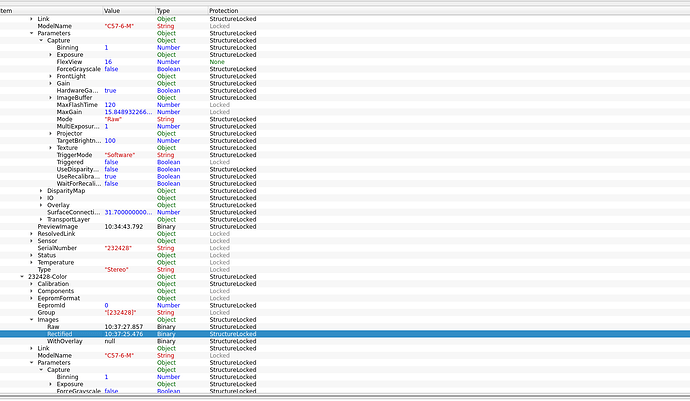

on third screeshot the rectified is same as raw camera . please help me on this for nect stop
The “Camera Images” view in NxView shows the raw image for color cameras. For the stereo camera it show the rectified images. I think this is what you were talking about initially. This is something that you cannot change.
You can save the rectified color image from NxTreeEdit by right-clicking on the timestamp in the value column and selecting “Save binary data as”. You can also use our APIs do get and interact with the data you want.

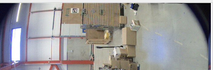

Our application requires dense coloured point cloud for our detection algorithm and one camera gives me distorted rectified image . currently we are using ros2 driver if there any alternatively we can get colored pointcloud and as you see in image this is the view of rgb camera rectified issue and from ros driver for this camera recieved same type of rectified rgb data
It looks like your problematic camera is part of a batch of cameras that have been shipped with a broken color camera calibration. Do you have an Ensenso calibration pattern that we could use to recalibrate the system on‑site? Otherwise you would have to send the camera back to us for a recalibration.
we dont have an official calibration pattern can it be printed and do the calibration
We actually have an in-field fix for the corrupted calibration. Select the camera (both stereo and color) in the “Select Camera” dialog and click on “Calibrate”. In the next dialog select the color camera and click okay.
