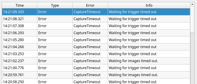

I have the camera wired to a hardware trigger (set to trigger on the falling edge of the signal) at slightly less than 0.5Hz and it seems to time out while waiting for the trigger every time. If I up the frequency to be greater than 2Hz it does not have the same errors. I tried to change the “Timeout” parameter within NxTree but those changes don’t seem to stick and the timeout errors keep happening. Is there a solution to let it wait longer in between the trigger signals?

The errors are still showing up even with the Capture Texture disabled. It is able to take photos occasionally (an improvement from before!), but it drops some frames unexpectedly and also accrues thousands on errors in between the firings of my hardware trigger. Is there a way to address that? Thank you.
Engage also seems to continuously display warnings on the bottom of the screen and runs into the same dropping frames issue (the triggers happen approximately every 0.4Hz, but it will drop every third or fourth frame or so and skip one iteration of imaging.)
