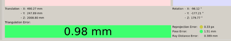

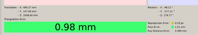

We’ve been using `X36-5FA-6/20/2400-400/2400` in our system for past 6 months and recently we experienced increased errors so we checked triangulation error in calibration wizard before conducting re-calibration.
We got green Triangulation error `0.98 mm` as you can see the attached picture.

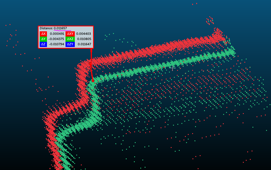

I suppose the green color means good. But when I compared the current pointcloud with the one from 6 month ago, I can see the 10 mm offset at 2.3m away from the camera.
Also, I can see a few pixel drift from right camera between 6 month ago and now, which suggests stereo rig is loose.
My question is that the green color doesn’t mean good results?
How to verify it if the system is in good condition if it shows green color even with loosed stereo rig?
Also, how far I should put calibration board? I imagine if I put calibration board closer, the error will be decreased.
Yes, green means good. The thresholds for it are explained in the guide linked above.
How exactly did you measure this? The error does not show in the measurement of the intrinsic geometry in your screenshot, which looks ok.
Note that you only measured the intrinsic calibration of the stereo camera. Did you calibrate the position of the camera and did you try to measure that as well. If not, is it possible that the whole camera has moved relative to the scene?
It is very unlikely that something within the stereo camera assembly is loose and you cannot observe this by measuring the intrinsic calibration as you did in your screenshot. The intrinsic calibration is very sensitive and any moving parts of the camera invalidate it very quickly. This would produce a measurable error in one of the error metrics in your screenshot. I think it is more likely that something outside of the camera has moved.
Note that the position of the pixels in the rectified (not raw) images is not fixed in general. They can move due to a dynamic recalibration without affecting the position of the resulting 3D data. As explained above, I don’t think this is the problem in your case, though.
We have ply file from 6 month ago. So we compared pointcloud using CloudCompare.
We compare pointcloud based on the camera coordinate system. Also, I compared right and left images between 6 month ago and recent one, and I confirmed that there is no difference in left camera but I can see a few pixels drift on right camera image, which suggests the stereo rig might be loose. (And we adjusted in vergence angle by ourselves)
But when the camera has a large view field (like yours) it can help with the accuracy of the calibration target detection. If you have one of the 48mm calibration targets, it probably appears very small at this distance, which can also introduce noise. We recently introduced the 96mm target to help with this.
Thank you for the information. We also couldn’t detect board if it’s placed farther than around 2m.
Actually the 6mm models use adjustable lenses, which differ from the standard configurations. @rkoma maybe you can you share the exact camera serial number?
Let me check serial number but we needed large scanning volume so we bought lenses separately and we adjusted vergence angle by ourselves so stereo rig can be loose due to our poor assembling skill.
But my main concern is that error we got is a lot bigger than error reported in the tool. It might be our fault that stereo rig got loose but I want to know how to verify that stereo rig has problem by calibration wizard. Or it is not main scope of tools?
The problem likely not your assembly skill :slight_smile: but usually the internal lens mechanics: in our standard models we use special lens designs with a static optics group inside. Most of the standard lenses with adjustable focus can be locked with a few screws, but even tightening the fixation screws does not prevent the internal mechanics from changing slightly, and thus decreasing the calibration accuracy.

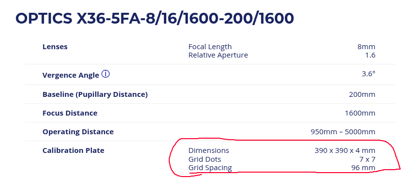

We noticed the datasheet specify 96mm target for most of the camera. Is 96mm target recommended for future calibration?
Also, why 96mm grid spacing with 7 x 7 grid becomes 390 x 390 x 4 mm dimension.

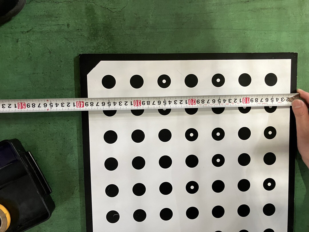

Here is our calibration board. is it too small for x36?
Hi @rkoma, the 6mm variant is indeed a bit of a customization, although the camera selector will show the model specs, if you enter them directly. But it will not return it via the search function. Anyway we have to find a suitable solution. Can you maybe give us some details of the required working volume, distance, temperature and vibration conditions? And then we will suggest you a configuration with static lenses. You can also send me a PM, so we can take the discussion offline.
Regarding the measurement of the error: the calibration plate can detect most errors, but not all. Especially for large viewfields and distances it is difficult to detect non-linearities of the measurement volume if the plate does only cover a rather small part of the image, because also the plate position is unknown and will be estimated in the process of the measurement.
If you have the possibility to print a custom calibration plate (a larger one), this would reveal non-linearities much more in the measurement process. There is the NxCalTab tool in the SDK to generate print data for different sizes, above the official pattern sizes.
