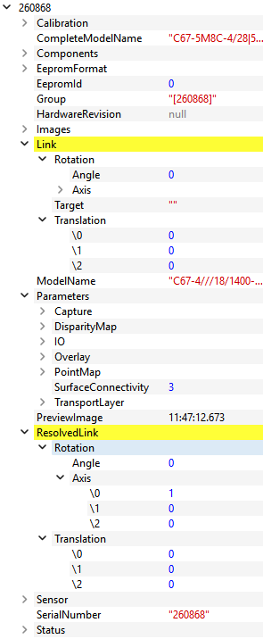

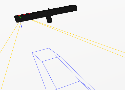

  • I saw the bounding box option but had misunderstood the documentation and couldn’t see a way to programmatically set the box centre, assuming that the Link had to be a pre-existing object. Having now seen that that is possible that does indeed seem like the better option and works really well. I am, however, having to inverse the Link Transformation unexpectedly to get the result I imagine. Would you be able to shed some light on that for me?
    Given that what I see in the NxView viewport has the Z-axis pointing out of the camera, I would expect that a positive Z value in the translation would move the box centre in that direction:
    However, I am finding that the only way to define a box in front of the camera is with Inverse: true or by negating the translations (and rotations but that’s less trivial by hand). I was testing with just translation to simplify but with Inverse set, all translations and rotations work exactly as I’d expect. Am I misunderstanding what the origin of that Transformation is? I can’t find any Links that have anything but default values that would be flipping the origin explicitly:
    This isn’t critical because, as I said, Inverse fixes it in one Boolean but I feel like I must be misunderstanding something.

For the interpretation of transformations in the NxLib see this page. A “Link” always uses the object it is attached to as the reference coordinate system and allows you to specify the target system. A “Pose” is the inverse, which is also used in some places of the API.
Unfortunately most transformations in the NxLib are specified as Links for historic reasons, which is the opposite of what most users expect. Setting the Inverse flag ist the easiest way to use it.
Perfect, thank you for the clarification. I’ll stick with Inverse.
