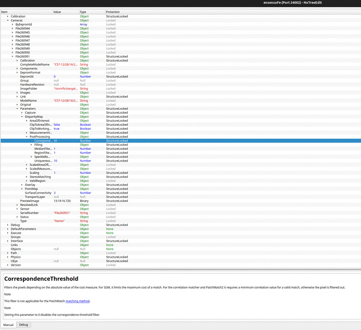

From the printf: setting /Cameras/File260951/Parameters/DisparityMap/PostProcessing/CorrespondenceThreshold to 10
Since res is zero. There is absolutely no indication why this value is not being set. NxTree also shows that the value sticks with 60.
Okay, I think the situation is cleared, the nxLibSet call was using a path where the camera part was missing … so just /paramters/DisparityMap/PostProcessing/CorresponcenceThreshHold.
But instead throw ItemNotExistent the Error Code was no Error. Even more confusing, the Default Value seems to be set to the Open Camera, despite there are different Setting stored with the camera.
Hi, a file camera is always opened with default settings and one has to apply the parameters that are shipped alongside the filecam. You can read the set of parameters shipped with the filecam under "Cameras/<serial>/Original/Parameters" using the nxLibGetJson method and write it to "Cameras/<serial>/Parameters" using the nxLibSetJson method, see Using File Cameras — Guides - Ensenso SDK 4.3.1057 Documentation
I think there was no error since “/paramters/DisparityMap/PostProcessing/CorresponcenceThreshHold” got created.
